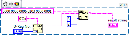

Since I want the user to be able to choose the register I created a mechanism for that and replaced the substring constant (07D2) with that code.
hex string snippet 2.png(note that the value entered in the D-Reg No. control is 2003.)
Although the conversion from the I16 control to a hex string produces 07D2, the resulting hex string from the replace string subset function produces this, 0000 0000 0006 0103 3037 4432 0001.

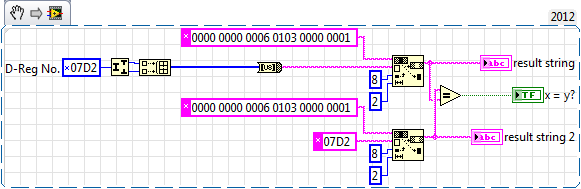

First, when formating strings you are better off using the Fromat String Vi rather than replacing elements in a string. However in this case your format to string is retrungin you the ASCII representation of the number and hence you get the wrong value in the output string. What you need to do is replace the bytes in the string with the actual binary data, not the ASCII representation. One way to accomplish that is to simply flatten the number to a string and then replace the bytes. You could also typecast the number as well and then replace the data. Here is an example.

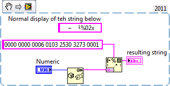

Adding to Mark's comments, here is an other way but along the same lines.

I typecast the number to a hexadecimal string and that did the trick.  Thanks.
