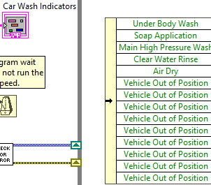

Hi, i been trying to create this unbundle by and bundle by for a cluster
^ - it basically repeats the "car wash indicators" when dragged down

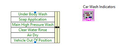

but problem is when i do it.. I can't figure out how to make that happen..  This is what i can only get
complete newbie to labview here.. so any feedback would be much appreciated

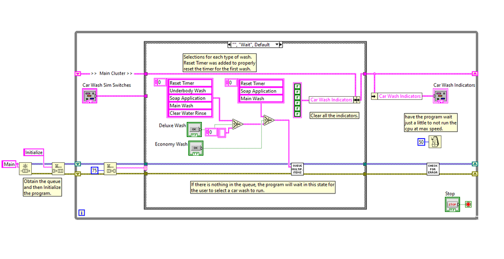

Exactly! but based on a reference i'm using which is this .. It's like somehow they've managed to select all elements for the bundle or unbundle.

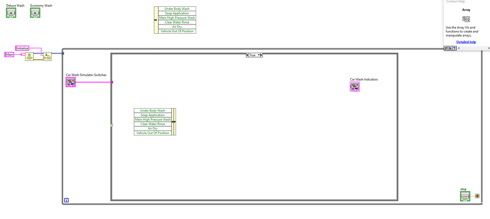

So.. me trying to implement it on my project doesn't seem to have any way of possibly doing it.. This bottom one is mine. As you can see i'm not able to create the bundle/unbundle with all elements selected. Hence, it's in green. My situation is that i'd like to select all elements (make it in the pink)

Their Main Cluster has a cluster in it. The clusters are nested.
The Car Wash Indicators is a cluster in the Main Cluster. So Car Wash Indicators cluster is an element in Main Cluster, and can be selected.

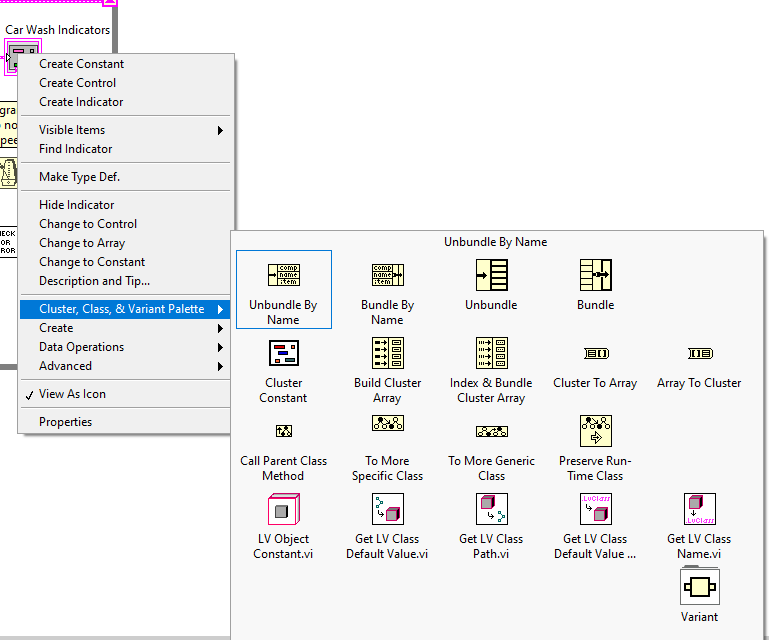

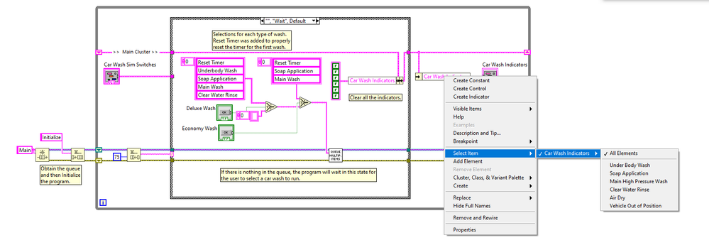

Okay, but really one last doubt.. How come when i right click and unbundle/bundle by their car wash indicator cluster right.. it gives out the boolean lists like this. I mean yeah i get your point about cluster inside a cluster but even theirs doesn't show the pinkish unbundle/bundle by name ..

When I create an unbundle from a cluster in a cluster, I get the cluster as the first element.
Not sure how or why that's different in their application. This would probably be a 2 minute face to face conversation, but hard to do over text...
The screenshots seem to be from your application, where it's just the Booleans in a cluster? Not a cluster in a cluster?
Anyway, by clicking the (un)bundle element, you can pick any element. Of there is a cluster, you should be able to pick it to get the cluster as an element.
