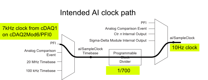

Hi, I am trying to use a clock signal on a PFI line to generate a clock, but at a lower rate, for a AI task.  I'm running into many issues that I cannot explain.
I have a cDAQ-9172 with an analog input module (9225) in slot 3 and a digital input module (9411-2MHz DI) in slot 6 (where the PFI lines are accessible).  I want to use an external signal on DI0/PFI0 to act as the clock for an analog input task on the 9225.  That signal comes from anothr cDAQ chassis and is too fast for the AI task so I intend to use the Timebase input and the clock divider (as shown on page 31 on the cDAQ 9172 manual.)  See image attached for graphical representation of my problem.
If I wire the signal "/cDAQ2Mod6/PFI0" in the DAQmx timing VI, I obtain the error -200414 saying that the "Requested sample clock source is invalid."  That is strange since it is listed as a "Direct Route" in MAX. (The polymorphic DAQmx Timing VI is configured as "Sample clock") Q: Why is this direct routing not allowed for the Task?
If I use the DAQmx Timing property node and change the "Sample Clock Timebase Source" to "/cDAQ2Mod6/PFI0", the task starts without any error but the divider seems to be forced to 256.  If I try to change the property of the Timebase Divider, I get Error -201100.  Attempting to change the "Sample Clock Rate" does not have any impact on the Task and the divider remains at "256".  Q: Why is the "Programmable Clock Divider" locked at 256 when using the PFI line or can you just not program it directly?
Another error that I ran into is the minimum speed on the PFI line.  If I wire a Rate (for the SamplClock Timebase) below 1MHz, LabVIEW returns error -200077.  The error message says that the minimum value is 1MHz.  The 9172 manual shows the 100kHz clock being an option for the Timebase, definitely less than 1MHz.  Q: What are the upper and lower rate limit for a clock signal on the PFI line for the "ai/SampleClock Timebase"?
I've looked on the website and in the DAQmx documentation for more explanation but I have been unable to explain these strange behaviours.  What are the limitations on the Timebase PFI input and the Timebase "Programmable Clock Divider" that prevent me from achieving my goal here?  If I cannot do it directly, could I use the PFIn signal to feed an internal counter (to act as the clock divider) which could then generate the AI clock at the rate I wish to use?  Would this method allow me to perform an arbitrary clock division (unlike the "256" that seems to be forced on the PFI as a SampleClock Timebase.)

Hi Julian,
Thank you for looking into my issue.  The reason the AI module can't be tied its own chassis clock it is in is that the two cDAQ slowly drift apart over long period of times.  Therefore, one cDAQ must provide the clock for both.  This probably explains why I have an external clock but dpesn't solve my problem.
I understand that modules don't have counter but the cDAQ has them.  Still, you can use an external signal on a PFI line to "drive" an internal counter and use that counter output for the AI clock.  However, even though I mentionned this as a possible solution in my original post, it seem that I won't need to explore that idea since I can get the proper clock at the proper rate on a 9211 module in slot 8 of the same chassis.  The problem I originally described only seems to apply to the 9225 in the slot 3 of my cDAQ.
For the 20MHz and 100kHz timebase clocks, please look at the image I included originally.  The clock path comes from the 9172 user manual.  It clearly shows the 100kHz as an input to the multiplexer selecting the "Timebase input".  Therefore, I don't understand the requirement for 1MHz, when a 100kHz clock is eplicitely available, unless it is specific to the 9225 module.

You description is correct until you get to the second cDAQ.  I want to divide the frequency before using it for the AI clock.  So instead of simply using the DAQmx timing, I use the TimebaseSource property to select PFI0, configure its rate and the target AI clock rate (so that the divider can be configured properly.)  Also, I will start the two AI tasks prior to starting the counter to synchronize the tasks!
At this point, I think that this method works except that my original failure implementing it was caused, it seems, by the 9225 Cmodule.  I am very much interested in understanding why that module (9225) cannot perform my desired "clock routing" and what other modules this restriction applies to?  As another example that the 9225 module is "different/special", using the cDAQ2/Mod6/PFI0 line directly into the DAQmx timing VI returns an error, unlike other AI modules supporting that connection.

I received some extra help on Friday from another engineer at NI and the solution to my original problem is actually very simple to achieve the following clock path from an external source:
w:
The idea of selecting a PFI line for the "Timebase" and the "Programmable Clock Divider" (actually, DAQmx compute this number based on "AI Sample Clock Timebase" and "AI Sample Clock") works by using the property node below:
(SampleClock.Source cannot be set until the task is committed/reserved but the default option seems to be Timebase which works well in this case.)
The issue I described previously with the 9225 comes from the properties of the module and the fact that it is a "Sigma-Delta Module".  That module usually generates its own 12.8MHz timebase clock (p.14 of 9225 document #374707C) and the clock divider has a lot less possible values than other modules (has to be a multiple of 256). It can use a different timebase coming from a PFI line but it has to be between 1MHz and 13.15MHz.
So, sharing a master clock between two chassis and running tasks at different rates shoudl be easy and straightforward with most modules.  Using AI modules with Sigma-Delta converters add extra limitations and the master clock rate for the timebase must be selected to accomodate those module as well.
