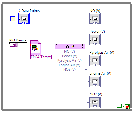

Below is a screenshot of my troubleshooting VI.  It simply reads in 5 analog inputs and this particular VI crashes after approximately 896 loops (and this is repeatable).

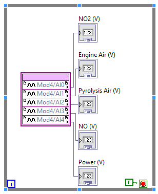

I'm not sure if this helps, but this is the VI that is called by the FPGA Target block above.

Do you see the same behavior if you move the Open FPGA VI Reference outside of your while loop?
(3,473 Views)
My bad, haha.  That worked, and I suppose it makes sense as I was opening over 800 FPGA targets (would explain the slowdown and eventual crash).
Thank you!
