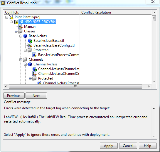

The above issues are tolerable, if somewhat annoying. What's concerning is the most recent error I received this morning. I had just run the top level VI from source (and verified it was running), went to make myself a coffee and came back to this error.
LabVIEW: (Hex 0x661) The LabVIEW Real-Time process encountered an unexpected error and restarted automatically.
The VI wouldn't have been running for more than 10 minutes. I've since tried to reproduce the error without luck.
This is somewhat concerning as the application for this cRIO will be 24/7 process control. Is this a known issue with the newer Linux RT controllers? Is there anything that can be done to detect the error in LabVIEW?

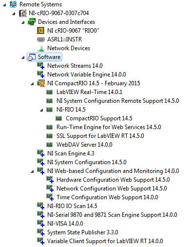

Below is a screenshot of the software installed on the controller:

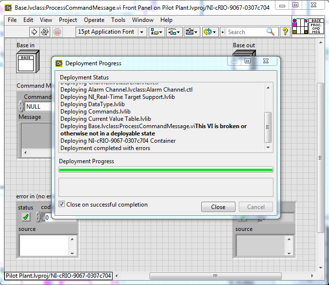

After about six hours this issue has cropped up again. This time I was just about to run my top level VI from source, when the project suddenly lost connection to the cRIO. Attempting to run from source again threw the previous error (0x661). Attempting to run from source again then gave me the below issue (note the run arrow in the background isn't broken):
A restart of LabVIEW fixes the above error, but this whole experience isn't exactly confidence inspiring.
