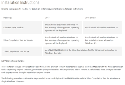

Hi
The longer version of why it cannot work follows.
You want to use versions of three tools that don't match. Windows, LabVIEW and Xilinx.
https://www.ni.com/en/support/documentation/compatibility/17/labview-fpga-module-compatibility-with-...
As of LabVIEW FPGA 2016, the Xilinx Compilation Tool for ISE cannot be installed on Windows 8 or later :
https://www.ni.com/en/support/documentation/compatibility/19/compatibility-between-xilinx-compilatio...
LabVIEW 2018 FPGA Module Xilinx Compilation Tool for ISE 14.7 :
Regards
Message 3 of 26
(3,948 Views)
