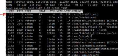

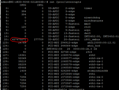

  I have been running into high CPU usage on a cRIO-9048. Even with no RT VI's running, I am often in the 30's of percents. I have done a little digging, it seems that the i801 SMBus is firing lots of interrupts. This interrupt is consistently consuming 20-25%, sometimes even more.
Does anyone know what this is for? I am considering disabling interrupts for this per instructions linked below. However, I would really love to know what it's doing before I go and disable interrupts.
EDIT : I did have an NI9870 and NI9871 (serial interfaces) configured to use "Real-Time Scan" so they appear as regular COM ports. I switched this back to "LabVIEW FPGA" thinking that maybe this was the source of the interrupts. It is not 😞
