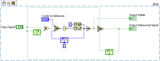

i agree with bruce.  the first fix would be to use differential signals.  if your encoder to does not generate differential signals, i would filter the inputs like Bruce suggests.  however, you have to be carefull of the maximum transistions per second required vs the sample frequency.
Stu

First I'd like to thank you all for your suggestions, it's definitely getting us closer to an answer.
Bruce, I tried implementing your digital filter and it works awesome...except unfortunately it's not fast enough. The signal is now extremely stable, but the side effect is we now have to move the readhead incredibly slow for an encoder read to occur.
Is there a filter that is quicker than the U32 filter? I tried to see if I could create my own but it looks like the "Rotate Left With Carry" is limited to U32 only.
(By the way, as you can probably tell I am a LabView noobie, my training is in HLL's so I appreciate the assistance!)

try the attached filter.  try setting n=5 to start with and move higher if you still have issues.
Stu

Mine can easily be made shorter by changing the U32 values to U16 or U8.
Bruce
