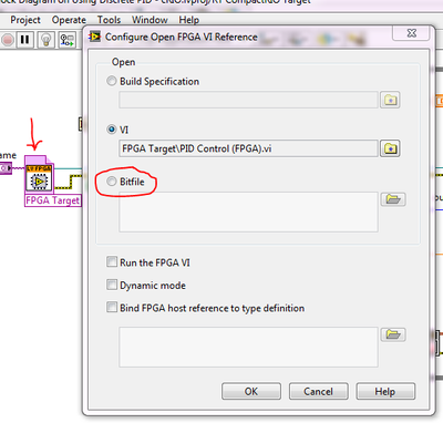

It becomes a little more complicated to ftp the bitfile. One way to do it is to ftp the bitfile to a location on the cRIO and then modify your Open FPGA Reference VI in your RT app to look for that spot.

Thanks Holly. That's very helpful about the RTEXE. I won't be able to run MAX on any of the machines that are permanently connected to the cRIO, but that modification of the Open FPGA Reference VI sounds promising.
