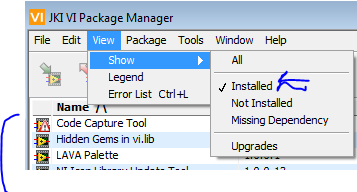

You did not mention Toolkits
You can get a list from the VIPM
(3,220 Views)
There are no toolkits installed
