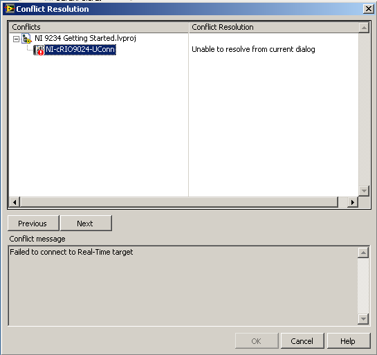

Hi, I have compiled (build as start-up) a stand-alone application on cRIO and it works good.
Now when I plug the Ethernet cable into the cRIO to connect to cRIO in order to remove the previous application and build another one, I can not connect to the cRIO due to the following error.
I was wondering how to solve it.

First steps - have you confirmed that the networking to the cRIO is still correct? When you plug in the ethernet cable, can you ping the cRIO (from a command line)? Can you see the cRIO in Measurement and Automation Explorer? If you can't access it at all, then there's a networking problem. Check your IP address, and firewall settings.
The cRIO has a set of DIP switches, one of which disables any startup application. If you set that switch, then reboot the cRIO, can you then connect to it? If so, there might be a problem with your startup application - perhaps you have a loop with no wait which is preventing background networking tasks from running (such as allowing connections from the development environment).

I used the on-board switch "NO APP" and then turned cRIO on.
Now I can connnect to cRIO.
When I don't use the swich "NO APP" I can not connect to my cRIO.
Does it mean that my code has bugs?
Message 3 of 15
(4,846 Views)
It probably means that your application is loading the processor so heavily that the cRIO does not have time to service lower-priority tasks like accepting network connections from the development environment. It's possible that your application really does need to do a lot of computation constantly, but more likely it means you should look at whether your application is loading the processor unnecessarily. The first thing to look for is any while loop that doesn't have a timing mechanism inside it (such as a Wait).
