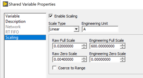

I've got it scaled in the analog inputs properties, 0-600A / 4-20mA.
And I have just a basic while loop with the AI0 shared variable wired to an indicator.

Simple calculations:
7A gives a sensor output of 7A/600A*16mA+4mA = 4.187mA, which is your expected value.
Reading 4.09mA instead gives a scaled value of (4.09mA-4mA)/16mA*600A = 3.375A, which is what the indicator is showing.
So all your values seem to fit, the scaling itself seems to work as expected!
