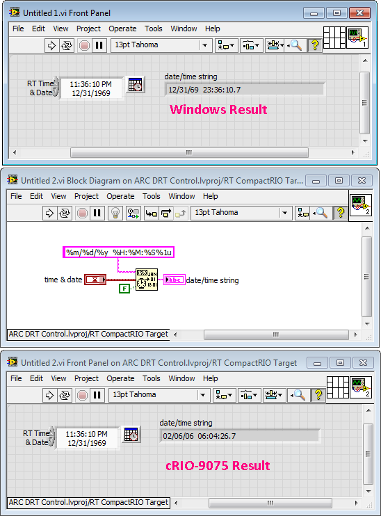

When a cRIO-9075 first boots, it shows in a TimeStamp indicator, a system time of around 4PM on December 31, 1969.
If I take that timestamp value and pass it into a "Format Date/Time String Function" to get a string representation of the timestamp, the date/time the string gets really messed up. The same code run on a Windows system works flawlessly.
What might be causing the format-stamp-to-string function to fail on the cRIO?

Yes, the system is setup for UTC - 8:00 and what you say must be the reason for the behavior.
I can enter a value of 11:59:59 PM on 12/31/1969 and get a bad conversion to a string (02/06/06  06:28:15.5 PST).
Yet when I enter a value one second later of 12:00:00 AM on 1/1/1970, I get a good string result (01/01/70  00:00:00.5 PST).
