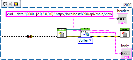

i want to send the following message via the Labview Post VI:
curl --data "j2000=[2.0,3.0,0.0]" http://localhost:8090/api/main/viewhttp://localhost:8090/api/main/...
The message is working via the win10 command prompt window but not in Labview.

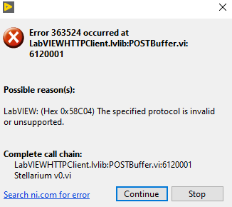

Here is the code snippet and the error message
Greetings

The input to that VI is a URL and a buffer.
The HTTP post VI has nothing to do with cURL, which is a command line application that does the same as the VI.
(5,233 Views)
Accepted by topic author Andreas111
Wire the URL to the URL input.
Wire the data to the buffer input.
