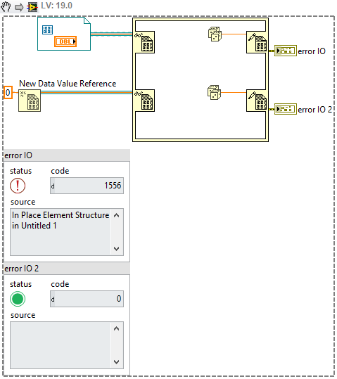

Is there an Initialize function or similar for the "HIK Vision" class that you're not calling?
This shows basically what you're doing, and what you're missing:
In the first case, the constant is used as a DVR input. This is equivalent to a class object that never set the DVR using New Data Value Reference.
In the second case, I call New Data Value Reference, and there is no error.

If that's the first VI you call with this class, then I'd guess you're never creating the Data Value References (DVRs).
They have to be created using New Data Value Reference (with the appropriate data type, but the value doesn't have to be what you want - you can populate that using the Open.vi you shared for example).
You can then use a normal "Bundle" or "Bundle by Name" node to put the DVRs inside the class, for later use with the In-Place Element Structures.
