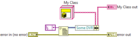

Here's an example taking a class constant and creating the DVR:

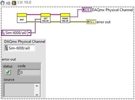

You could use it like this:

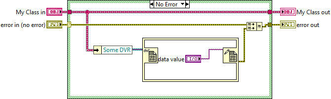

The "Set Value" VI is just a dummy, but it looks like this (approx like yours):
Here I didn't close the DVR - you should also in a real application use "Delete Data Value Reference", probably in some sort of "Close.vi" for your class.
