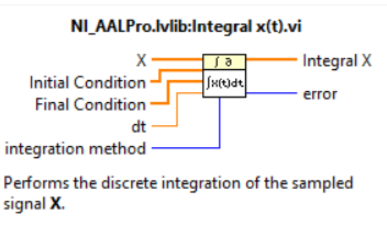

hi,
you could use the following function (from the mathematic palette) :
(2,535 Views)

thanks, I did not know the function "add array elements"
