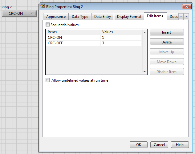

You should be able to only have the two options you want in the menu ring. Right-clicking on the ring control and choosing "Edit Items...", you should get a dialog with a table of Items and Values. If you deselect the checkbox for "Sequential values", you can then edit the values associated with those items.
Donovan
(2,954 Views)
haha, how in the world did I miss a box that says "sequential values"?  wow.
thank you.

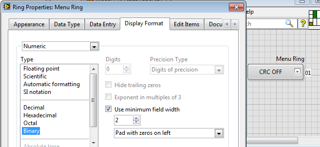

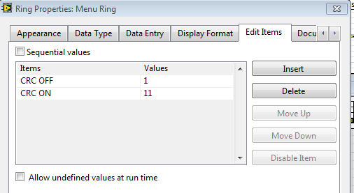

You can even play with the display format to make that bitfield "Look Right:
Although it would be kind of nice if the item editor respected the choice and updated dynamically when the display format changes.  (It only bugs develoers- Users never see the page)
