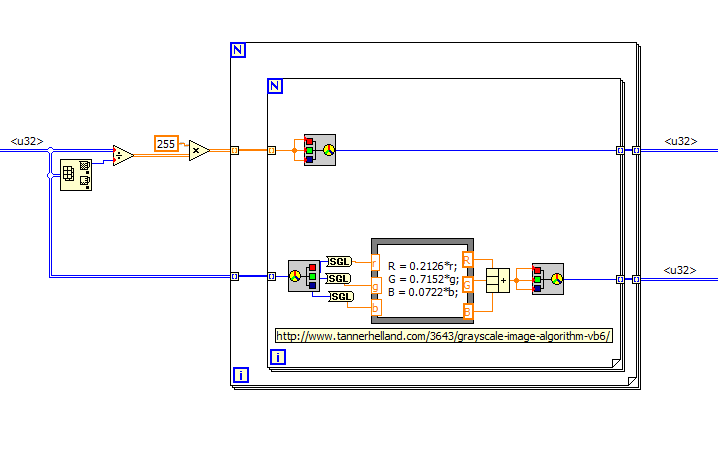

hi jimmyinct3,
I I don't have access to Vision, so I can't test if my approach would work, but I think this is not a Vision-specific task.
Here's my plain Labview approach2014-03-23_grayscale.PNG:
Please note:
The color input-picture is in u32 as well as the grayscale output-picture
Alex

I'm not sure the VI is what you want, I've saved it to LabVIEW 2012.
You can try it:)
