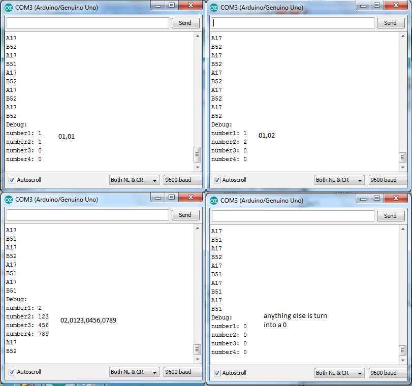

if i write in the serial monitor from the arduino 01,01 and hit enter digital write(7) turns off, if i write 01,02 turns on, so i guess it works right? if i wirte for instance 02,###,###,### i set the colors of an rgb led.

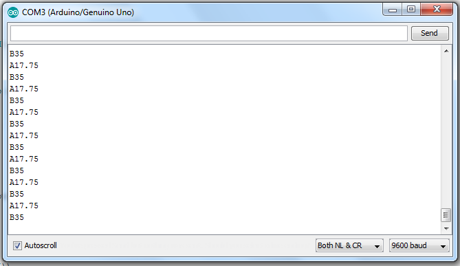

as you can see arduino send every loop the values of the bs18d20 and the pot
A##.##

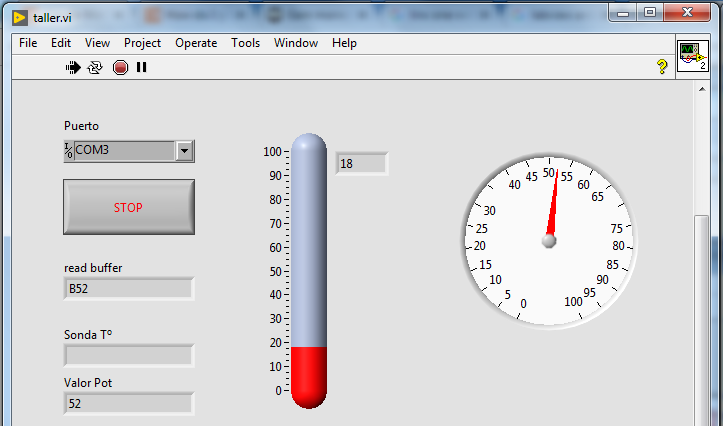

B###serial monitorserial monitorLABVIEW SIDEit works reading (taller.vi)it works reading (taller.vi)

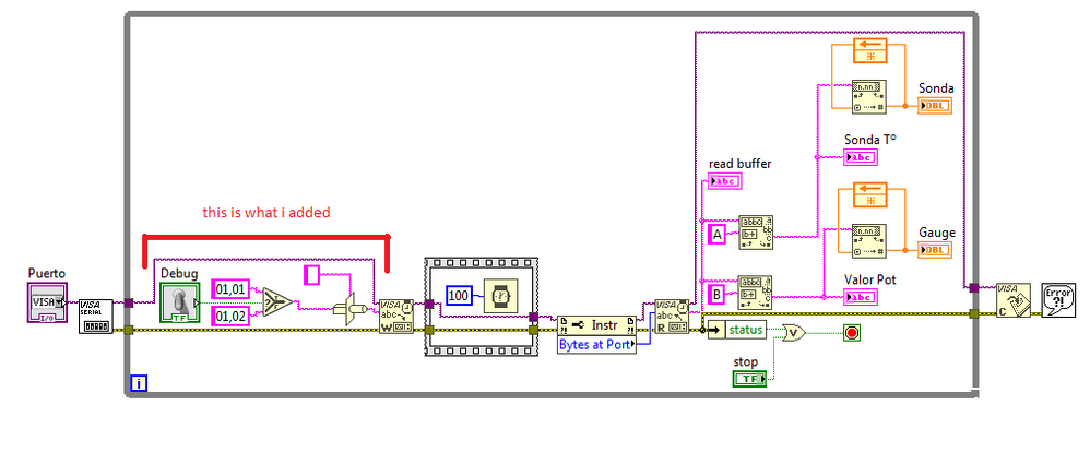

so finally i add a switch and a visa write, but then the program does not recieve nor send a thing (and doesnt give any error)
taller-02.vitaller-02.vi
taller.vi only reads
taller-02.vi try to write
so this is it guys, i really dont know what i'm doing wrong and it's driving me crazy, any help would be appreciated... PLEASE HELP! u.u

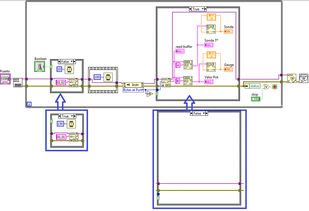

i'm srry guys taller-02.vi was a wrong file, here is the current try-to-write file, with a little improvement
what do you think?what do you think?

Remove "Bytes at port", it is not used when reading a line with a terminal symbol (carriage return). Instead of this function, put a constant, for example 100.
Check what actions Arduino performs when receiving the package. What he does if the package is wrong. Make sure that Arduino correctly accepts the parcel.

thank you for your answer Borjomy this is how arduino behaves with diferent inputsthis is how arduino behaves with diferent inputs
in the labview side there is an improvement after deleting the bytes at port, for that i cant thank you enough!
so after watching for a moment this is what i read in the read buffer

after a few test i did in serial monitor, this is what arduino is receiving for each state of the boolean switch
01,0101,0101,0101.. or 1,0101,0101,0101
02,0202,0202,0202... or 2,0202,0202,0202...
if i enter 1,101,101,101
arduino responds with
Debug:
number1: 1
number2: 1
number3: 1
number4: 1
(3,363 Views)
