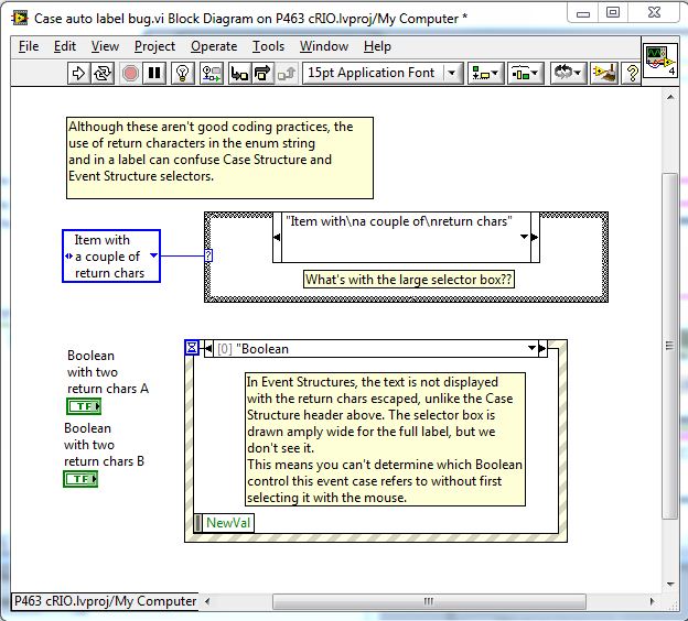

On the subject of structure selectors, there are couple of trivial display errors that could be addressed:
21728i81F5CE3351775A90

I tried the first post with LV 2010; and I'm not able to reproduce the error over there; Labview keeps the space in the case selector.
I will do a request on the second post to see if the behaviour on the event structure can be improved.
