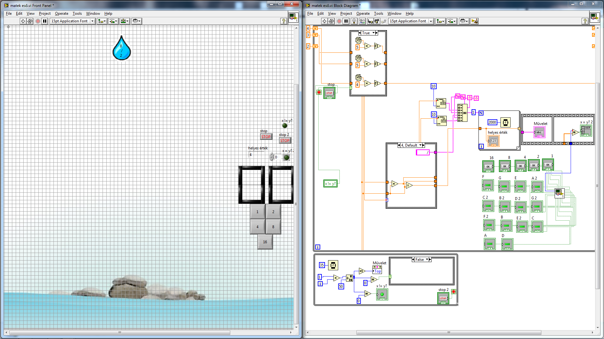

How can i do that in case structure that when true generate 3 number but when the case structure is false then dont do anything.the problem is that when case structure is false then the outputs are not wiredNévtelenddd.jpgNévtelendsdsds.jpg

What would you like the values to be when the case is false?  That is what you should wire up in there.

when it's true then generate 3 number and show them.the values must be the same until the structure is true again

Then follow the advice given in your other thread and use shift registers on your outer loop to hold the latest values.  You can just wire those values straight through in the false case.
If you just want to show the values in indicators, you can place these indicators inside the case structure and they won't update unless the case is true, thus displaying the stale values if the case is false.
Can you show us the rest of the code? It seems you are making significant beginner mistakes that should be addressed now.

when the raindrop reached the bottom it starts again on the top.always generate a number at the top and while it doesnt reach the bottom the numbers must be the same

Pictures are completely useless here, especially if they are truncated and contain overapping and hidden elements.
Attach the VI instead.
