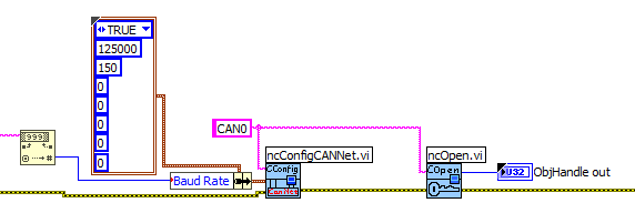

Hi salmaiss,
this is the core routine:
All you need is the ConfigCANnet function (found in old NI-CAN Frame API)!
(I hope you are using NI CAN hardware…)

yes I did that but still, when I change the baud rate after running the application I miss the connection

Hi salmaiss,
when I change the baud rate I send a message to the all  devices to change the baud rate also
It's quite hard to read your block diagram because you don't use AutoCleanup as often as needed…
Which "devices" are you talking to?
Do those devices understand the CAN message your are sending?
Are they receiving that message?
Do they answer with an OK or ERROR status?
my question to be able to change the baud rate on all devices using CAN message after running the app.
You need to read the manual of your devices to learn how to change their CAN interface baudrate!
Usually I have to power off/on devices before they start to use a different baudrate. And usually you don't change the CAN baudrate after a communication has been established…
Message 8 of 21
(5,427 Views)
Generally, the baud rate is setup up on opening the database.  The connection cannot occur if the connection parameters are not set properly.  Likewise, Connection parameters should normally be changed after closing the current connection and before the next.
In your attached PNG file, their is no apparent flow control on where your sub-vi (5) occurs in the process.
