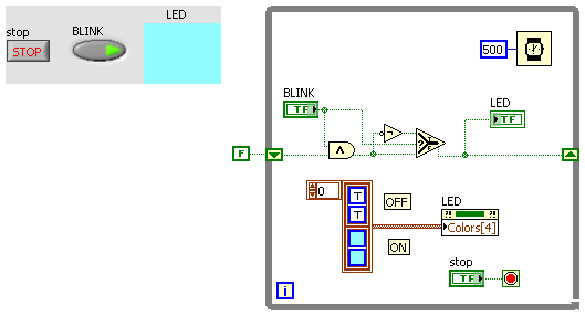

You can also set the actual FG/BG colors on the controls to simulate blinking, but each class has different properties for these. I once did something like this, but never actually needed it for anything, so I didn't do anything past that test code - http://forums.ni.com/t5/LabVIEW/Frequency-of-Blinking-for-LED-in-LV/m-p/327367#M168545
If you really need this, you can do something based on that, but I would suggest bringing it up to a higher level. Today I might do something like that as an XControl, but that requires understanding XControls.
