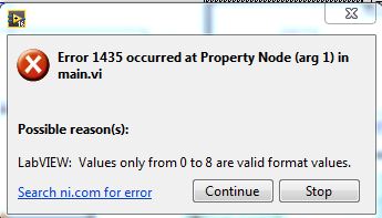

very simply i need to have fixed  number of digit after decimal point .
I thought i can do it with :
X scale -> Display format precision
but i have faced with this error :
As i scale programmatically scale x-axis (because having more margin) i try this way :

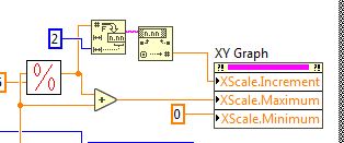

convert float to string with desire precision and then convert it to float .
it works but i thought maybe ther is better way .

To set number of digits programmatically, you can use "Format string". It does not have 8 digits limit. You can check format strings when you switch to Advanced editing mode.
%#.2g - automatic formatting with 2 digits after decimal point. If you remove #, it will show trailing zeros.
"Increment" is a distance between major ticks. You can also kind of control it using format string by specifying minimum string width
"%-15.2g" - minimum width 15 digits, "-" fill with spaces on right, 2 digits of precision, show trailing zeros.
