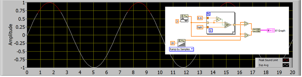

I've been struggling with a labview project where you need to change the plot color of a graph based on the seconds that need to be ignored,(see attached image) The seconds in the beginning and end and some in between need to be ignored/shown in red.
My idea is to use the select tool to determine the plot color of the xy graph, not shown in image. If I do this I can't determine plot color of the graph for the slices to ignore because it is a 1D array. How do I fix this?

You can use a graph with two plots of the same data, make parts of one or the other NaN to only show one of the colors.

I won't be dissecting all your code and try to decide which the several graphs you are talking about, but here's what I had in mind.
