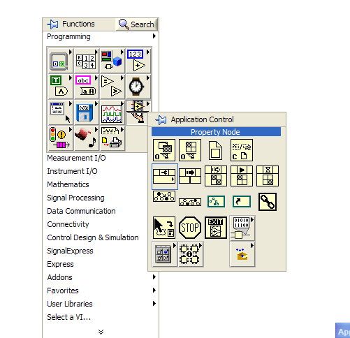

You will need to use propery nodes to do this. If you look on the tool palete you you find them here:

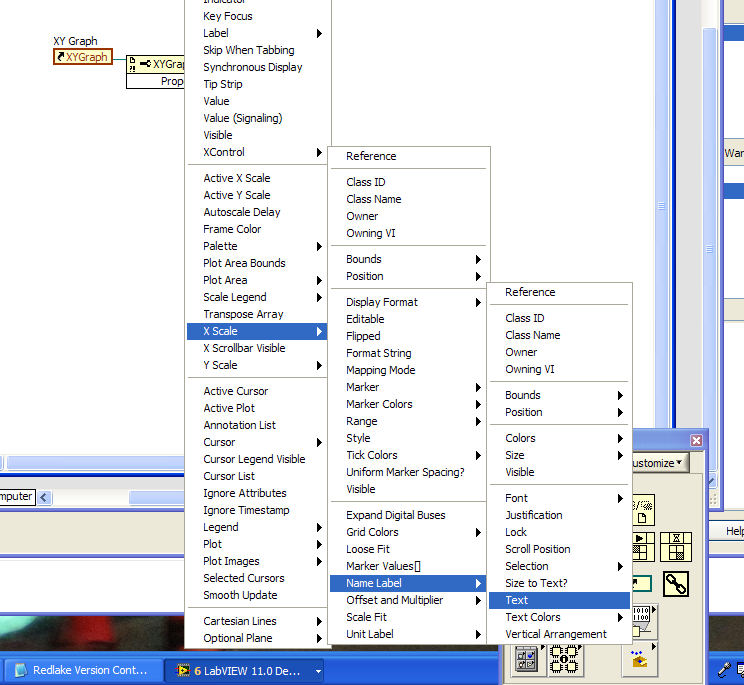

Then you will need to find this property
