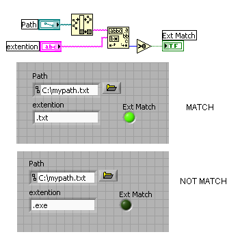

Here's an alternative method:
Message Edited by JoeLabView on 06-01-2007 09:24 AM

Unfortunately JoeLabView's version will find the extension anywhere within the filename, so for instance "c:\path\txtcheck.vi"  will show as a .txt file [The comparison is for an pattern and "." will match ANY character]
This selection should all work; including one that will look for either .dat or .txt in one test. Add error in/out as appropriate.
Message Edited by Rod on 06-01-2007 03:13 PM
Message 6 of 10
(4,600 Views)
Sorry, Joe's test won't match c:\path\txtcheck.vi, but will match c:\path\atxtcheck.vi
Rod.
