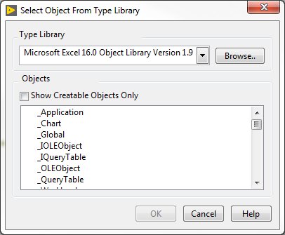

I tried this, using:
And picked "_Application".  I always got Error 3005 (Automation Open: Object specified is not creatable), even on a computer with Excel installed.
I went back to select "Select ActiveX Class...", and switched on the "Show Creatable Objects Only" (very important).  Now, "_Application" disappeared, but "Application (Excel.Application.16)" shows up.  Using "Application..." works great.
By the way, these tools are on the Connectivity/ActiveX pallette.
