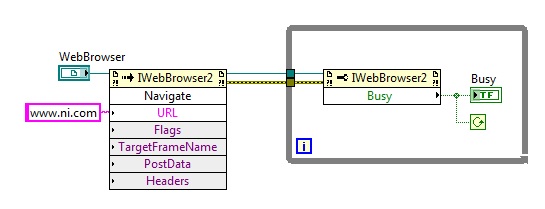

If you use the ActiveX WebBrowser control in LabVIEW you can call the Busy? method to determine when the embedded browser has stopped downloading the page.

by the way... newbees question, sorry, but how to create the "webBrowser refnum" and the related property node? I'am always struggling with refnum creation when I try to duplicate some examples...
thanks !
antoine
From the Front Panel drop a .NET & ActiveX > WebBrowser control down. This create the block diagram terminal from which you get the reference handle Smiley Happy
Firefox doesn't support ActiveX because that's a Microsoft concept, which they're opposed to, therefore they don't host an ActiveX interface. Internet Explorer however does have an ActiveX interface, and that is what is embedded in the ActiveX WebBrowser control.
