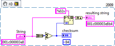

How do I calculate the 8 bit modulo 256 checksum?  See the example from the manual.
Example:
            To send the Set Temperature of 100.0 Deg. to controller.
            Fixed Decimal Set Temp is multiplied by 10 to prepare to send.
            Convert 1000d to hex which is 03e8
            Send:               (stx)001c000003e8b4(etx)
So..in the example the checksum is b4.
Thanks in advance.
Gary

Darin,
Excellent! I had initially tried that but it didn't seem to work.
Thanks!
Gary
