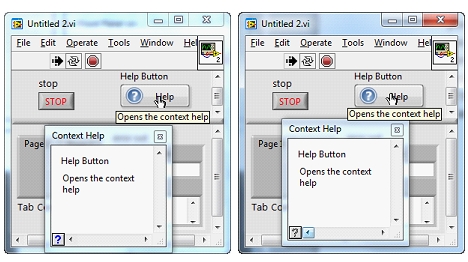

The screen shots won't say much but here it is. Sometimes, the help file is available (left), sometimes it is not (right).

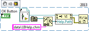

  7. In the case of a VI template, the help path of the documentation page does not work when in an executable. The only method I found is to dynamically assign a “Application directory/data” to the help path using a property node, assuming that the help file has already been copied in the data directory for another VI or for a control (see code snippet below). This code can be used in any VI. I found it to provide more consistent results than relying on Labview to assign the correct file paths.

I've re-built the application in LabVIEW 2013 and done some testing to see if I can re-create the problem.  I can't.  I can see the problem only in the executable you sent me.  When you build an executable, however, and want to deploy it to the target, you will want to use programatic context help paths anyway.  The method I used to accomplish this looks as follows:
Create a static VI reference, and then use a relative file path to set the path to each control.  When I use this method, and then include the help files into my executable, I can programatically change the file path for the Type Defs.  This seems to be a better way of setting the type defs, in a way that the path will be relative to wherever the executable and its respective data directory are located.
