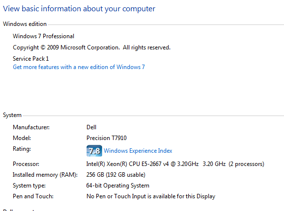

Here is computer info (names were changed to protect the innocent).

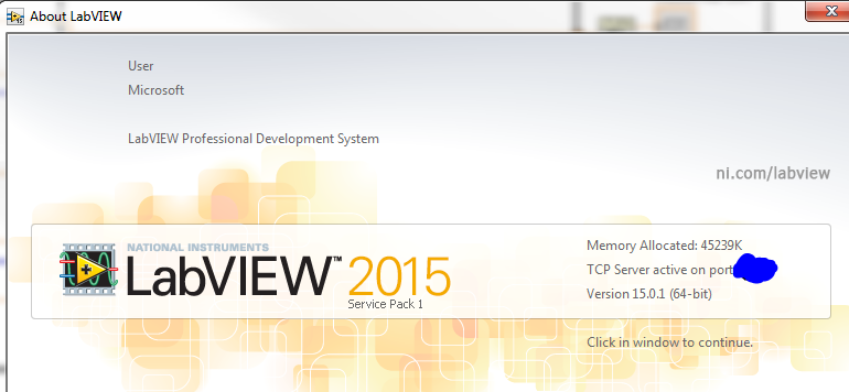

Here is version information for LabVIEW (names again changed to protect the innocent)
What gives?

There is no need to blank out the VI server port on your About screen.  It is probably the same has everyone else's and in the neighborhood of 3363, 3364, 3365 ...
Knowing that port is really not any kind of security risk and is meaningless unless we also know your IP address of your PC as it would appear to anyone outside of your domain.
