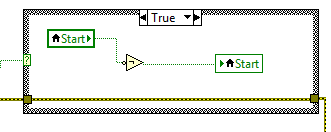

So I saved its state:

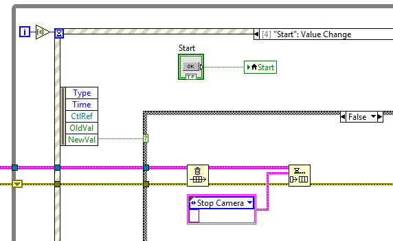

... and in anothe part of the program I try to switch its state:
the problem is that when the switching happens it only partly works, e.g. I see the button label switch Start<->Stop,
but the associated methods (e.g. shown above "Stop camera") do not fire, as if the case structure <"Start": value change> is not activated...
any hint?

Hi!
Try changing button's value via property node-> value(signaling). This will trigger the event structure

Hi alessandro,
I hope you don't mean this copy operation from terminal to local variable as "saving": What's the purpose of reading a terminal and writing this value back into a local variable of the terminal/control?
This looks like heavy overuse of local variables!
but the associated methods … do not fire
These are no "methods", it's an event structure handling events!
As said before: writing to local variables will not fire an event. Only UI actions (well, mostly) do fire events - and special property nodes…
(4,838 Views)
