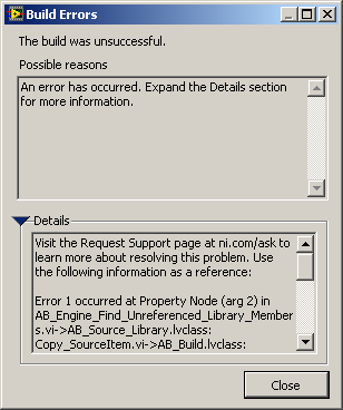

It was perfect for cRIO to build and to deploy. But when I build the windows program, which (automatically) includes the cRIO.vlib, then comes out the error. It said:
Possible reason(s):
LabVIEW:  An input parameter is invalid. For example if the input is a path, the path might contain a character not allowed by the OS such as ? or @.
NI-488:  Command requires GPIB Controller to be Controller-In-Charge.
Possible reason(s):
Without using the function block were the both windows program and the real time successfully built.
(3,979 Views)
The errors you have posted are indicative of a file path problem, either from using non-explicit paths (which Development mode understands but Windows EXE does not), or, a path could be too long or buried too deep in subfolders causing the path to be too long. Investigate this before placing blame on the boolean array block.
Richard
(3,955 Views)
the reason I blamed the collect boolean array function block is that if I delete the function block, the whole thing works!
And also it works well on the real-time without error.

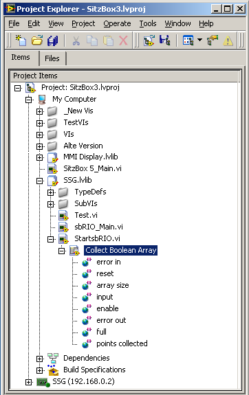

My project likes like this:
19859i82A1ABB0D05799F1
PS: the SSG is our real time (sbRIO).
(3,945 Views)
Your project organization looks great, but regarding filename size, what matters is where the files are on your computer - if you have nested them so deep that Windows hit the limit path size.
I have never used that boolean block thing, but when using certain things on Real-Time platforms, you have to be careful to include files in the build specification.
Richard
(3,934 Views)
