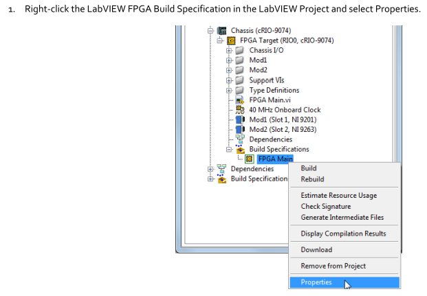

I'm following this guide in particular: LabVIEW FPGA Sample Project - But i am also experiencing the issue in all other projects that i do
To set the FPGA for "Run when loaded to FPGA" i must open the build specifications as shown here

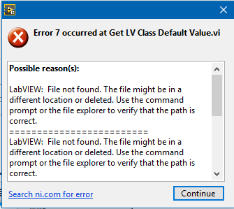

However, when i do this i encounter the following error:
The full error text says:
Possible reason(s):
LabVIEW: File not found. The file might be in a different location or deleted. Use the command prompt or the file explorer to verify that the path is correct.
NI-488: Nonexistent GPIB interface.
Complete call chain:
Get LV Class Default Value.vi
AB_UI_Initialize_Framework.vi
AB_UI_FRAMEWORK.vi
niFpgaBuild_Item_OnDoProperties.vi
niFpgaComp_Item_OnDoProperties.vi
niFpgaComp_Item_OnDoProperties.vi.ProxyCaller
LabVIEW attempted to load the class at this path:
<Empty Path>

I also noticed that in my project explorer i do not have the FPGA icon for the build specifications, but instead i have a questionmark like this
Does this indicate anything regarding the error?
(6,039 Views)

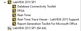

Do you have the FPGA toolkit and CompactRIO drivers installed? If you look in MAX under software, do they appear under the version of LabVIEW you have installed and/or the software list? The question mark in the build specification usually indicates that the FPGA toolkit isn't installed/licensed correctly.

I have both Compact RIO drivers and FPGA Module installed for LabVIEW 32-bit.
However, the FPGA toolkit you are talking about. For the compiler I have downloaded and installed just the LabVIEW FPGA Module Xilinx tools.  Is there something extra that i need?

Sorry - yes, I meant the FPGA Module - it should be installed under 'LabvIEW 32-bit' in MAX.
To build an FPGA VI - you need to either use the compile farm (to compile the FPGA on NIs servers) or the Xilinx tools (to compile locally on your computer).
(blog)
(5,992 Views)
I have FPGA Module for 32-bit LabVIEW

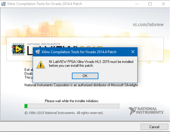

This morning i saw that i had an update for
LabVIEW 2015 FPGA Module Xilinx Tools Vivado 2014.4 f1 Patch
When trying to install i get the following error
When i search for "Ni LabVIEW FPGA Xilinx Vivado HLS 2015" all i find is this download page which is the exact tool that i have already downloaded and installed.
