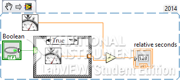

I want to begin with a simple "stopwatch" instead of triggering by signal, i want to trigger it with switch. So, my VI is running, and when i press switch it starts counting.
I tried to do this with a case structure.
But there is that problem, if button is off/on type (because thats how my start end condition will work like) if its on both 'relative time' counters are running at the same time thus result is 0.
Even if button would be latch when pressed, it will read value from 'relative time' but as soon as condition turns false, the previous value is replaced by 0 (deault value, exit terminal cant be unwired in "false" condition).

Oh well that's very different and can be done.  Sorry I didn't understand your post.  Yes your code is a good start, but in the false case what you really want, the the value that was there when it was true.  You can keep this old value, by wiring it to a shift register on the inside of that loop.
(3,266 Views)
Okay I figured I could come up with a quick example instead of just words.  Here is an example VI that will measure the amount of time it takes for a filtered signal to cross a threshold of 5, from when the control signal crosses a threshold of 5.  My filter is a 6 point average and some white noise added.  The important thing to take away is how the time is kept in the shift registered, and updated when the condition is met which in this case is when the value is greater than 5 but it was less than 5 before.
