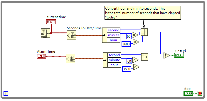

Message 7 of 10
(4,256 Views)

That won't work if you aren't in GMT and you are trying to compare times of day.
Let's say it is currently 11 pm.  I want to see if it is after 6pm.  I'm in eastern daylight savings time.
6pm today would give me a value that is higher (thus later) than 11 pm.
Luckily LabVIEW has this nice feature called subVI's that can hide the ugly parts of Chris's method and lets you reuse it.  😜
