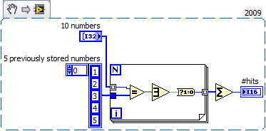

For eg- I have 10 numbers and I have to compare them with 5 priviously stored number at the same time ...means I have to check that out of 10 number the how many number matches with 5 priviously stored number ...what block should i use for this kind of comparisons in labview?
Something like this?
