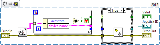

This routine looks at all of the input devices.  The first one that has multiple axes is chosen as the (probable) Joystick.  Note the outputs of the Query Input Devices function, shown here, contains a lot of useful information.
