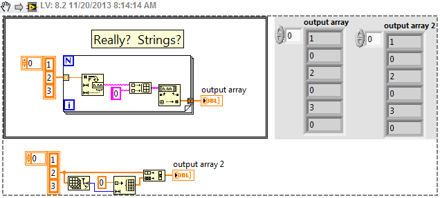

Try the attached VI

Your "solution" is undeserving of kudos.  There is absolutely no need to convert to/from strings to perform this operation.
That's not concatenation, that's interleaving that you've described.
I agree that the string conversion is silly, but would point out that the option selected for the loop output (right click, Tunnel Mode) uses the NI term "Concatenating".

@PhillipBrooks wrote:
That *is* concatenating; I was referring to to the OP's use of the term.  I replaced the concatenating For loop with an Interleave Array node.

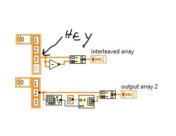

Of course if you want to save a couple scalar buffers (that really don't need to be there) and a bit of real estate.
SIDE NOTE: Smart compiler in 2013!  it really only has one of the duplicated array constants allocated.
