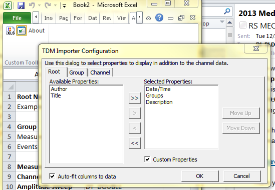

The user guide http://www.ni.com/white-paper/4906/en/  says "...click on the symbol Configure TDM Importer."  I am using Excel 2010.  I do not see an icon for Configure TDM Importer.  All I see in the add-in ribbon is the Import and the About.  I have tried un-installing, re-installing, rebooting, deleting the add-in then adding it back in.  Still don't see the Configure icon. When I click the import icon I only get the file open dialog.  Can anyone offer any suggestions?  Is there a dedicated support forum for this add-in?   Thanks in advance!

You need to import a file to view the configuration glyph

there it is( Note: I imported <LabVIEW Data> Example Events Data.tdms after running the example "TDMS Write Events Data.vi" in 2013
