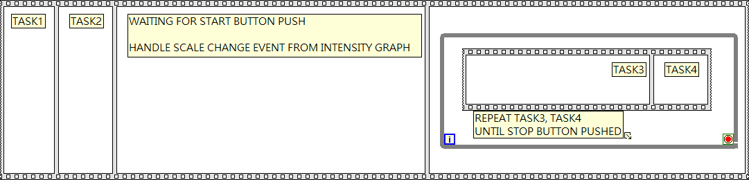

Hi altenbach, sorry for bugging again. I am trying to learn more from your comments but I try for hours, something still confuses me. I modified my code based on your suggestions and it works. Now, I smell some idea for the event handling in LV. But I am thinking the suggestion you made at the very beginning of the reply. You said Event structures should never be hidden inside sequence frames.  So in my extended code, I am going to implement something like that (pseudo code)
There are two places needed events handling: frame 3 and the last loop for STOP button. As suggested, I pull the event structure outside the sequence and try to maintain one structure for all events. In the implementation, to make it simple, I use time delay for the TASK1 and TASK2, for TASK3 and TASK4 the time day is randomly picked from 0 to 5 seconds (in real case, it could be waiting any times as long as couple minutes).
Since I pull the event structure out, I place a while loop in frame 3 and waiitng for the button pused to quit the loop and jump to frame 4.
I handle two buttons value change events. One for the button stop the loop in frame 3 and one for the last loop.
But some times, the button in frame 3 doesn't response and sometimes the last button doesn't response.
You miunderstood. More accurately I should have said that an event structure needs to be ready to service events. It cannot sit there while lenghty code is executing in other sequence frames and such. This also meas that an event structure needs to be in a loop so it is ready to handle the next event once one has completed.
Let's look at your code.
Dataflow: you are completely deadlocking your event structure. It can only execute exactly once per run and frame #3 cannot start unless the event structure has completed once. Depending on the value of the boolean, the inner greedy loop will no either spin forever as fast as the computer allows of will complete immediately. Same for the next loop, depending on the state of the boolean going to its stop terminal. Once these loops start they will read the same value forever from the input tunnel. They will never know if any of the booleans are changed again in the future, because these terminals will only get read once.
Your VI is basically dead and simply rolls over whenever it is run, rattling through the sequence frames. A VI needs to be alive and have a hearbeat. As said before, use a single outer while loop containing a single event structure to handle user intereactions and keep track of the current state to decide what to do next. You don't need any sequence structures and you don't need any local variables if it is done right. Look at all your duplicate code. You can re-use most in various execution states.
At this point I strongly recommend to first learn some basics.
Did you even look at the VI i attached earlier for some ideas?
