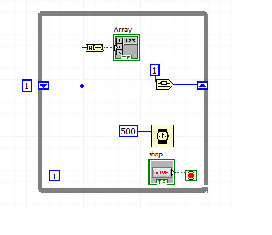

You can use one loop, Wire a 1 to a shift register.  on each loop, use the rotate function to rotate the bit through the bitfields.  Then either convert the number to an array of bools, or if your device supports it write the value directly to the port......

I guess, you configure with the assitant 1 Sample (on demand), that's what I tried with my own hardware. Then your assistant will have a data input that requires an array of boolean. As you just have a single line, this array should contain only one element.
Additional tips: You can simply copy the assistant for switching off after 1 sec. In that case the easy way is to use a flat sequence with a wait 1000 in the middle frame. The nicer way would be a delay as in the OpenG-Tools and using the error wires data flow for that.
