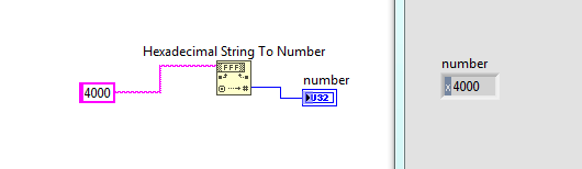

That's a crazy way to pass numbers.
Decimal to string.  Width of 4.
String to Hex.  Datatype U16.

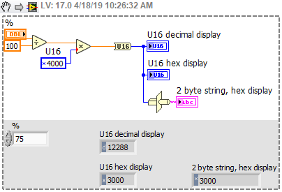

You are definitely thinking about it the wrong way.  It looks like 0-4000 hex is your range from 0-100%.  I'm not sure why it wouldn't scale to FFFF hex.
You don't want 4000 in decimal converted to 4000 in hex, the table doesn't show that at all.
The table is a somewhat confusing example because it never shows a "hex" character (A-F) except for 1% at A4.
Take your percentage, divide by 1000, and multiply times 4000, an integer constant formatted as hex display.
Example_VI
Message 7 of 11

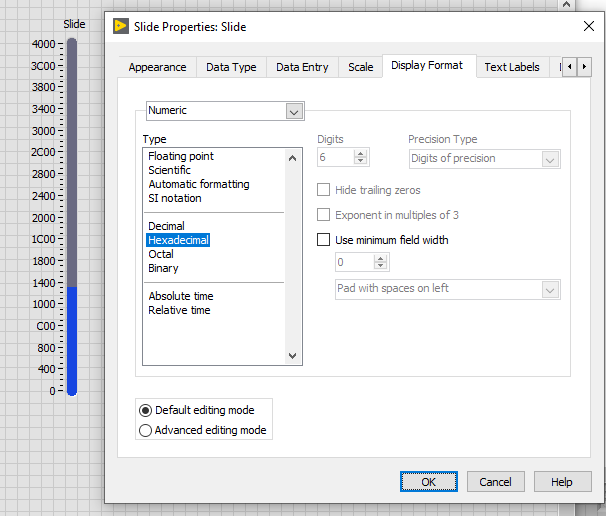

What's wrong just formatting the tick marks in hex? (make sure the slide datatype is U16)
