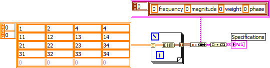

by doing this I want to then index through each row. The attached vi has the m x n array and the format of the output

I assume this directly relates to your previous question, right?
You did not attach any of your type definitions (there are two!), so I had to disconnect them. You need to substitute the typedefs again.
Try this as general possibility:
(1,524 Views)
You are in fact brilliant! I had disappeared down a rabbit hole building a manually indexing bit of code instead of using the auto indexing. Me thinks me and Rube Goldberg have a lot in common.
