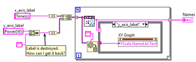

I use Variants to communicate between Queue State Machines similar to the Queued Message Handler Template. These Variants have type names which I use to distinguish between different values. I don't know how I can change them programmatically. At the moment I use String constants with static labels. The problem arises if I get the String from a VI, then I can't change the name.
Here a more elaborate example which is more similar to what I am doing.

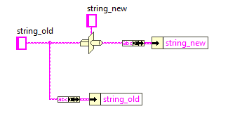

Type cast into the same type but label the constant you feed into the type terminal (also a quick and dirty trick for named probes which is how I found out about it):

Using Coerce to Type is safer, as you know it's not going to reinterpret the memory.
One day I'll get to move on from 2017 😭

@FireFist-Redhawk wrote:
"Coerce to Type" is available in 2017 (and earlier). It's just not visible in the palette: https://forums.ni.com/t5/LabVIEW-Idea-Exchange/Officially-Support-quot-Coerce-to-Type-quot/idi-p/121...
