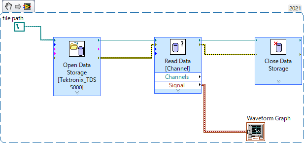

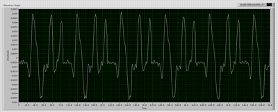

Is this expected waveform? I used dataplugin to read the file.
https://www.ni.com/en-us/support/downloads/dataplugins/download.tektronix-corp-dataplugin-for-tektro...

Thank you for your message and URL.
The data which you showed is what I would like to get.
Thanks a lot!
