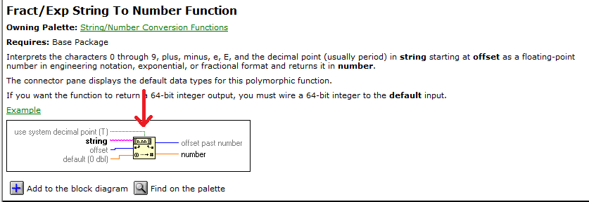

Exactly.!!!! If a False constant was wired into the top of the Fract/Exp String to number function, it wouldn't be using the default value of True which uses the system decimal, which for the poster is a comma rather than a period. It needs to be a period based on the data that is in the string.

Try setting the marked input to FALSE.

I'm trying to put the function false, but not ta working. Its help me please I sent the VI. please

I don't see anyplace where you have set the input to false or where you are using a Scan From String function. You have also not posted the subVI you are using. Please post a VI with the corrections that you say you have made.

I want to thank everyone who helped me by hints at what to do this transformation. The program worked. Much obliged. Thank you.
