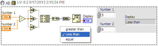

This is not the answer, but it's an answer.  😄
Post the VI you're writing and we'll help you learn what you need to write a proper solution (mine is slightly obfuscated).

You only need to make two comparisons. The rest is redundant.

Slightly obfuscated, Jim? Slightly? Smiley Very Happy
It does however point in the direction of an interesting solution to the original problem.
